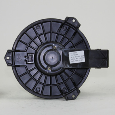

Thought this would be helpful to anyone looking to save time and money.
If you are in the market for a new blower motor, you've allready realized how expensive they can be. After searching and doing a bunch of research, I found a great deal. It turns out that the Blower Motor in the 06-10 Honda Civics is the same part # for the JK. Only difference is the price. There are a lot more results searching for the Civic Blower Motor. I found a brand new TYC replacement on ebay for $41 shipped to my door.
TYC 700194 Blower Motor AC Condenser Blower Assembly | eBay

Installed a couple days ago. Unit is identical to stock. Fit perfect and works great.
