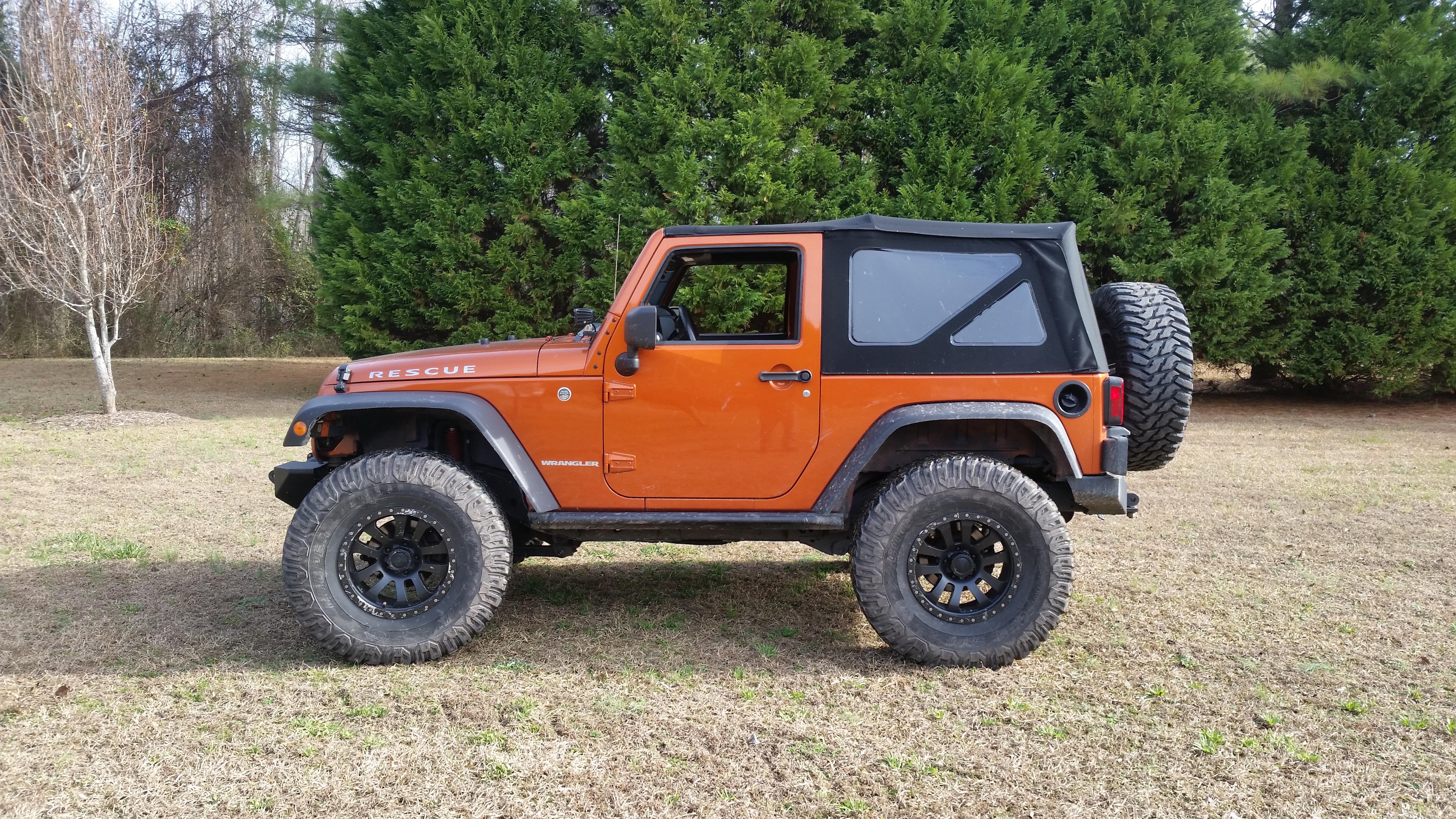

I don't see why you'd need more lift than you've already got for 37's unless you're opposed you trimming the flares back. I ran my friend's 37*13.5's on the street for a few months on my 2.5" kit. Full lock and some turn would rub on the Rubi rails but I'm not ruling out that it's because of the 13.5" width.

Attachment 666339

- i need to fix the rake , its killing me
- I thought that with the factory flares it might be too tight with 37's

Yes, full factory flares and 37's is absurdly tight. I get the extra lift now. Even then you'll want to check your rear bumpstops to make sure you don't contact them when you hit the speed bumps.
