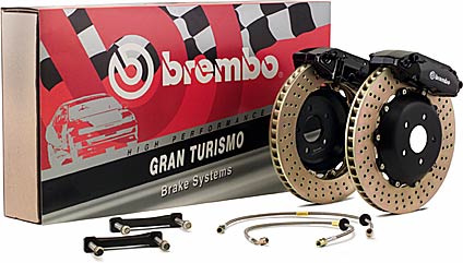

I also found out that BREMBO now makes a big brake kit for our JK's but its $$$$$ @ $3900
Talk about Jeep porn!!!
tirerack.com/brakes/brakes.jsp?make=Brembo&model=GT+365mm+Big+Brake+Ki t&group=GT+365mm+Big+Brake+Kit&autoMake=Jeep&autoM odel=Wrangler+Sahara&autoYear=2008&autoModClar=
The Brembos are 365mm(14.3 inches) compared to the Teraflex 13.3 inches.
As much as i love Brembos(have them on my E30 M3) I think they are a bit overkill on a Jeep, I'm going with the Teraflex BBK.

Love Brembos,but drilled rotors not very good on a Jeep since the holes get plugged with dirt and wear the pads prematurely. Slotted on the TF kit are better, flat may be best. I have the TF kit with their Master cylinder and really like the increased holding power. Highly recommend.
