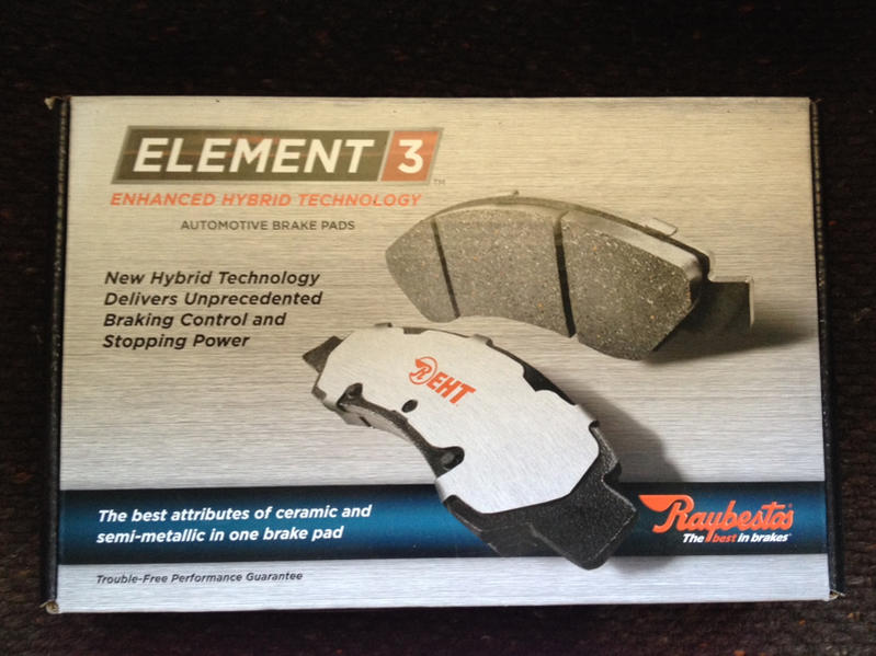

I just went to O'Reillys and picked up a set of ceramic pads, clips, those little rubber boots and grease. My local 4x4 shops had nothing in stock.
It was the easiest DIY to date.

Hmm. that looks interesting. I see they aren't tapered at the ends. The purpose of that taper is to help prevent brake squeal. In general, cheaper pads don't have it. More expensive pads have it. Have you experienced brake squeal with these pads?
