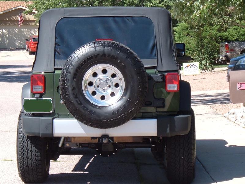

How noticeable the gap is has a lot to do with body color. Very easy to see on lighter colors, not as noticeable on my dark green.
This is without the bumper raise brackets. (still running the stock tire carrier with 37's, so need the bumper lower for clearance)
