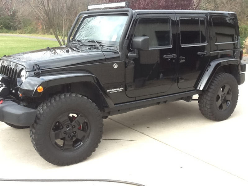

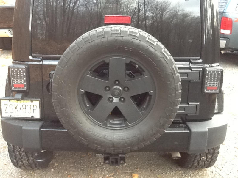

Here is my 12 with 1.75 leveling kit 1.25 rc body lift and 35's
