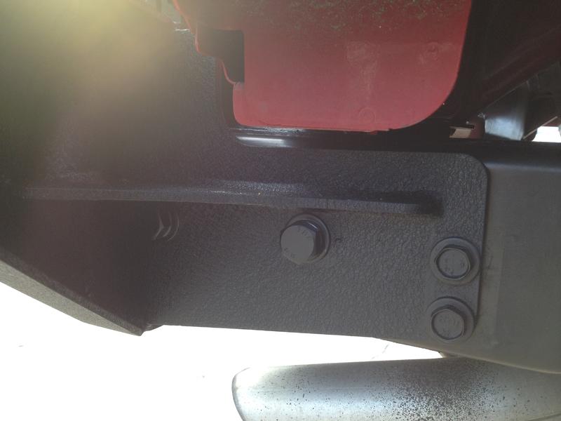

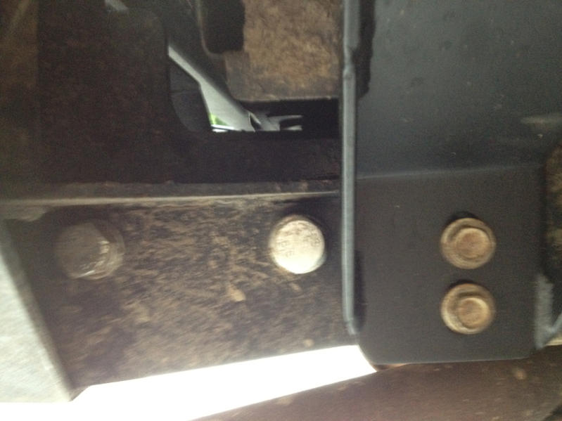

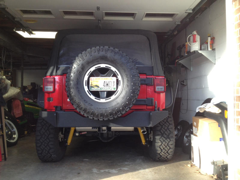

Has anyone installed a Body Armor rear high clearance bumper (and tire carrier) along with a Body Armor or other brand roof rack? I recently purchased a Body Armor rear bumper and it installed easily. However, I purchased a Garage Pro roof rack from JCWhitney, and it looks like the passenger side rear mounting leg/bracket will not mount up with the Body Armor rear bumper at the frame due to a support gusset welded on the back side of the bumper to reinforce the pivot for the tire carrier.

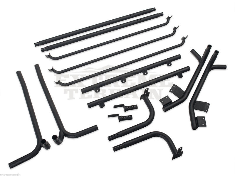

The Garage Pro is supposedly made the same as Body Armor, Smittybilt, Barricade, N-dure and other racks as others have said. See attached pic of my JK: You can see the rear mounts in the third pic, lower right, where the two large holes mate with the bumper mounting bolts and the smaller holes towards the front of the bracket align with the smaller holes on the frame.
I do not want to drill holes in my quarter panels using the alternate method used for stock bumpers, since it wont be as strong and may lead to damage later on. I'm still waiting on arrival of the rack so I haven't actually sized things up so I may be able to use a cutoff wheel and trim the gusset, assuming the tongue on the rear leg mount will fit under it, just wondering what others have experienced.

I have that rear bumper in the non-tire carrier version and that gusset is definitely not there.
Below is link to instructions from Body Armor for their roof rack and it does appear to be the same kit as the Garage Pro.
I wonder if you could clearance the gusset or possibly cut it out and have it re-attached (weld) after you install the roof rack bracket?
Body Armor has pictures all over the Internet showing that rear bumper and roof rack combo but I cannot find any that have a detail of the rear bracket.

Had to notch the gusset with a cutoff wheels to mount my Gobi.

Yeah that seems like the easiest solution assuming I get all the parts!!!
