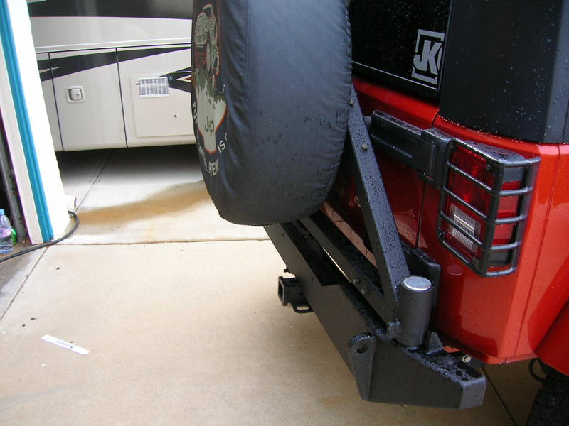

The install was very easy on a 09.
Iv got the rear and swing out tire carrier (5294) on mine and was surprised at how easy it was.
Here s a couple of shots of the way it looks on mine.
So far, I like it.
Mine is drilled and tapped for their can carrier which in next on the list of parts.
Hope this helps.
