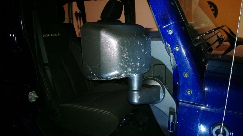

Just bought Die Tech mirror brackets.
They mount on the upper door hinge and bolt to the body - using existing OEM mirrors. They are both at OEM mirror height and placement. Awesome.
Heavy duty, no movement. Not cheap but - best I could find because I tow a 12' trailer daily and love to drive doorless. The Law is you need drivers side mirror and rear view mirror in most of the 50 States. To tow a trailer - you need passenger side mirror with 50 ft. clear visibility. This works for me - doors off and going to work.
I use Rugged Ridge 11025.10 mirrors. The mounting brackets go on to windshield pillar with existing T40's. The mirrors are quick disconnect, the brackets remain and are unobtrusive.
They are a good quality, adjust easily, stay where you put them and are a reasonable price. Amazon is cheapest at about $36 for the pair. (Plus shipping). Most others charge about $50-$60.
I also used 2" round convex mirrors mounted on the a/c vents before these were bought, but the RR mirrors do the job well.

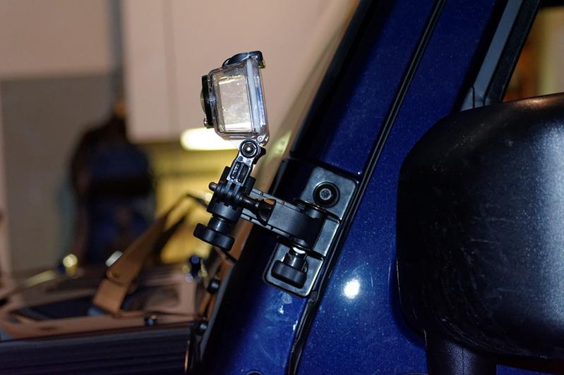

0 Posts
