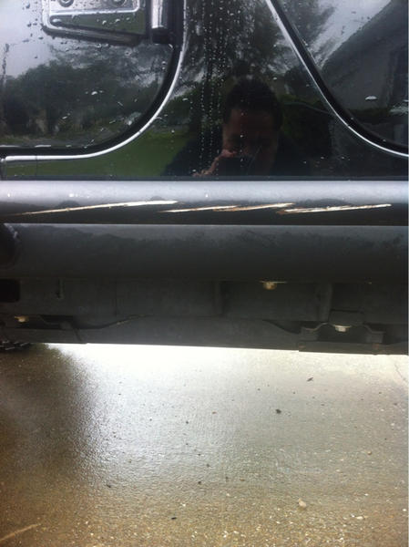

I use Rustoleum rust reformer and bedliner. Banged up my rails on a recent trip and they look good as new with a 2 minute touch up
