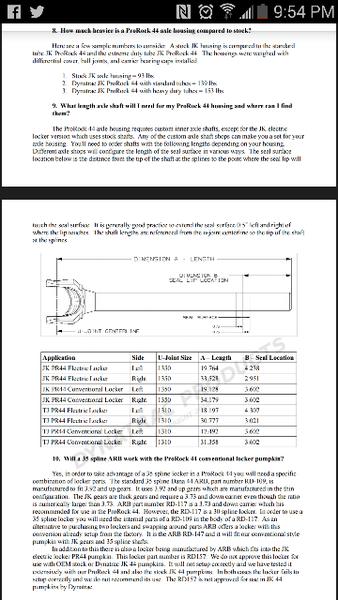

Thanks for the clarification. I am looking to replace my Dana 30 and do not want to be forced to use RCV axles. So if I am starting with a new axle housing I can get a "Rubicon" aftermarket housing and use any axle shaft, locker, gears etc. that I want to?

What's your email. I'll send you this dyntrac document. Sums everything up well
#20 on the attachment
