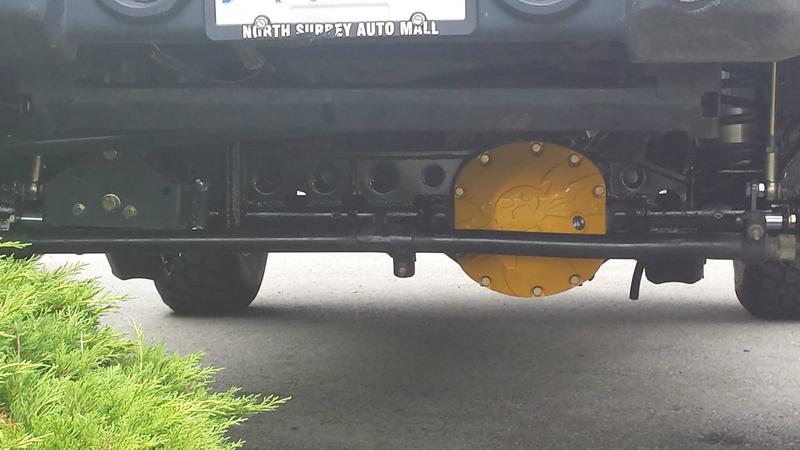

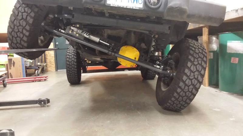

Just got mine done. Balljoints are required if you're completing the C-gusset weld on's. I sleeved mine also.

Looking good! Are those Fox 2.0's? Did you install yourself or take somewhere and if so cost? I bought sleeves/gussets (teraflex) and synergy ball joints. Debating on the Artec but think I will go that route. I don't think I need entire artec kit if I have the gussets with the teraflex package.
The Steering Stabilizer is a Fox 2.0, but i have Bilstein shocks. I had it done by a local jeep shop, which put the sleeves in first then welded the truss and C-gussets.
Truss - Artec
Sleeves - Synergy
C-Gussets - Artec
LCA Skids - Artec
Balljoints - Synergy
Axle Seals - Synergy
$1400 installed. Canadian.
