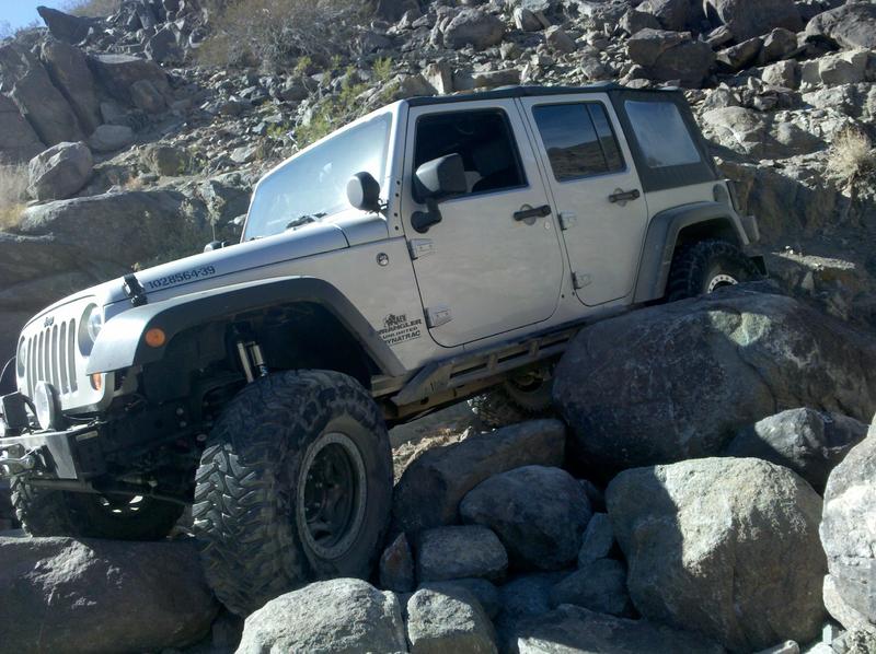

I'm in a similar boat running the OME 2" HD lift (with a spacer for 3"). Being a fan of the Hammer trails I have been taking on a lot of rock. Diff covers are important as the stock ones are easily dented. You'll want a really solid stubby front bumper with tow points and I love my M.O.R.E. stubby with bull bar. Full width bumpers get tangled in the rocks and block your wheels preventing motion. Rocker panel protection is extremely important, but I can't help you there as the rocker guards I have used have all failed me and caused tub damage. I run a full skid system under my JK, but the 2011s have less armor than prior years.
Consider upgrading your tie rod too. I know it's not armor, but it's one of the first things to get hit when making a mistake in the rocks. Also, relocate the steering stabilizer, it will get hit and die if you plan to do the rocks.
Below is a pic taken this last weekend at the parts shrine on Sledgehammer out at the Hammers. As you can see there are more items to armor up. The JK in the background has EVO skins, fenders, sliders, corners, and tire carrier and he still took damage where not armored (the A pilar).
