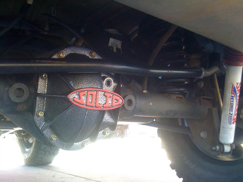

FWIW, your poll is kinda pointless. do you wheel on rocks? do you need a dip stick or can you measure the old fashioned way? these are things that are important to know before anyone can tell you to keep the stock one or what brand is best for your needs.
if you wheel, and need a dipstick, the ARBs are best
if you wheel and dont need a dipstick and dont mind painting, get Riddler
if you wont wheel on rocks, keep the stock one.
one thing you will find if/when you do upgrade is that the stock is extremely thin. i was surprised how thin my d44 covers were compared to my Riddlers.
my riddler front:
[IMG]
[/IMG]
