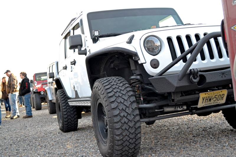

Join Date: Feb 2012
Location: HELMETTA NEW JERSEY
Posts: 128
Received 0 Likes
on
0 Posts
Line-x
