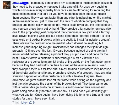

Nice I keep hearing the triple rates changed the game completely. On the other hand I just saw my first anti-RK rant on facebook and it has me wondering if this guy is just a RK hater or what.Attachment 599800
I've got AEV 2.5" and am building up to all MC control arms. Not that RK is bad as I've only heard good things about 95% of their products. I just prefer the joints on the MC's...
IMO, with former Chrysler engineers having brought input into the design of the AEV suspension I just think it's been tuned & tested better for daily driving / over-landing but is more than capable off-road for crawling.
I'm a welder and the only way a bracket gets torn off a frame is shitty welding lol. Installer error can't be blamed on the manufacturer.
