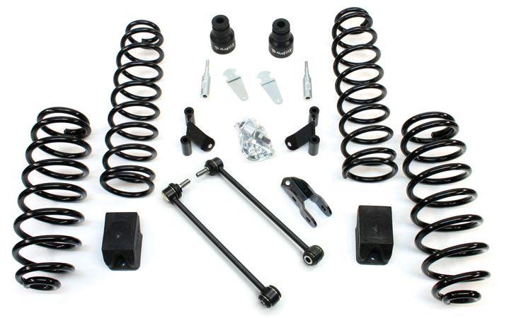

I am currently running the TeraFlex 2.5" lift and am going to swap out my coils to a 3.5" AEV coil.
My questions is, do I HAVE to run an adj front track bar? Id i don't what is the negative effects? tire wear, steering issues?
Lift I am running now:
