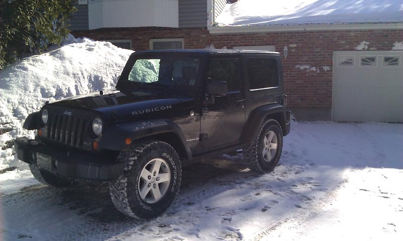

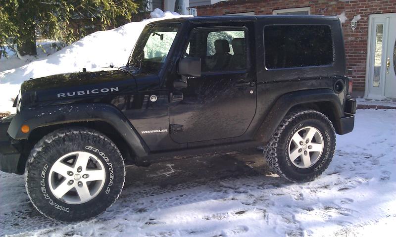

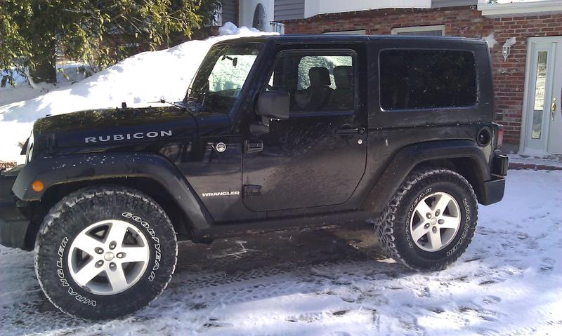

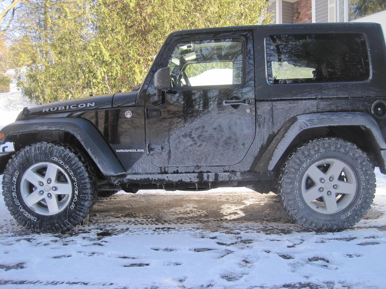

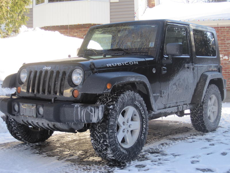

just put them on this morning . seem ok , gotta wait till playtime to be sure though ! look great too.Click image for larger version

ID:	123250 hope this helps . oh , they are duratracs !

Originally Posted by pucknuts
just put them on this morning . seem ok , gotta wait till playtime to be sure though ! look great too.Attachment 123243Attachment 123245Attachment 123247Attachment 123249Attachment 123250 hope this helps . oh , they are duratracs !
any rubbing issue in full turn?
