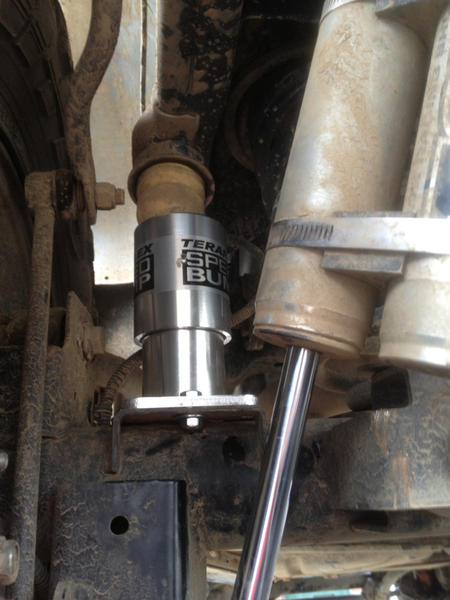

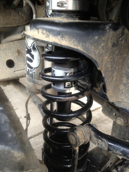

It can be done. I have a 3" Teraflex full flex arm kit with the speed bumps installed. Just make sure you order the strike plate for the rear speed bumps. Huge improvement on offroad quality and ride. I know longer bottom up with a jarring strike like before

Did it cost flex ?
I`m unsure if I should get this combo or get 2.0 Fox bypass shocks.
I´m a bit afraid that the speed bumps cost (a lot) of flex.
On the other hand its the P´n´P sollution and you can get adjustable Fox shocks.
With teh bypass ones you onla have the bypasses adjustable or hav to start messing around with shims and so.
![](/images/ranks/veteran_army.png)
I have been wheeling a few times since I swapped in my speed bumps and I haven't noticed any loss of flex. IMO it keeps everything under control under slow articulation (keeps the wheels down), but if you want to open it up on the trail the ride remains really smooth.

couple questions, does your upper bump stop touch the speed bump at regular height?
i had to jack up the frame a bit to install the speed bump
I'm not home right now and its been more then a few months since I've seen my Jeep but if my memory serves me correctly I removed the upper bump stop and installed a flat strike pad essentially making it flush with the frame. They came with the kit that I ordered.
