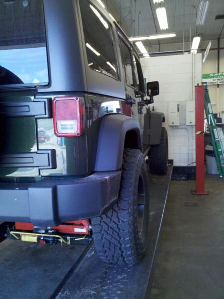

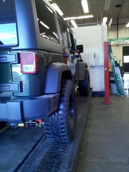

Just installed mine today and looks good with my 285's! If you do install one make sure you unbolt the brake lines, swaybars, and vents to provide slack to install the spacers. Other than that it'd bit the install is a piece of cake. Before and after!

Nice pics! Looks a lot taller than 2" though! I'm thinking 285 or 295's as well. Dealer is waiting for me to call back and close the deal on a 2012 right now...
