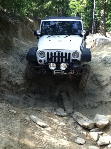

I have the 2DR TF coil lift and I ripped my boot disconnected probably around the time this pic was taken....
I just replaced the front driveshaft because I was feeling vibrations.

Heres a quick pic my buddy took. I wouldve taken more but my phone broke during the install and Ive yet to get a new one lol.
