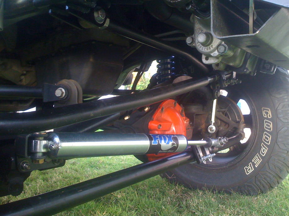

I went with the Teraflex high steer because I can use it with the HD forged Teraflex TB, the design is solid and all the feedback has been positive so far. Not to say that the AEV HS isn't any good, but IMO Teraflex is better.![Thumb](https://www.jk-forum.com/forums/images/smilies/thumb.gif)
