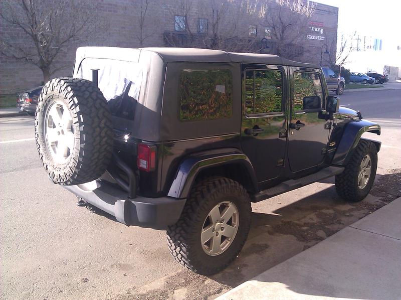

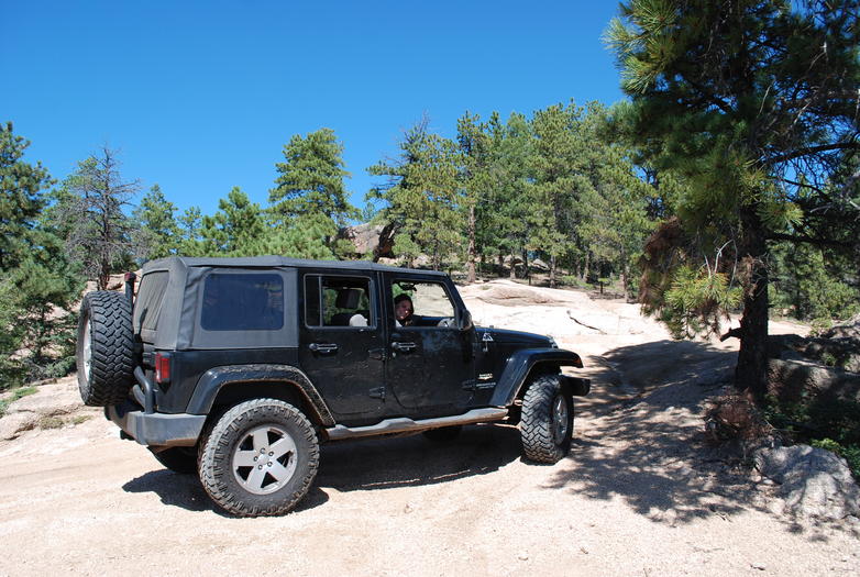

I installed mine all on my own.. It would have went a bit faster with an extra hand, but still pretty easy. I used a dremel and a hole bit, which helped a ton. Just make sure you get your adjustment right, when leaning it in to the vehicle it will make for smooth operation. Other than that..enjoy..
ID:	320465Click image for larger version
