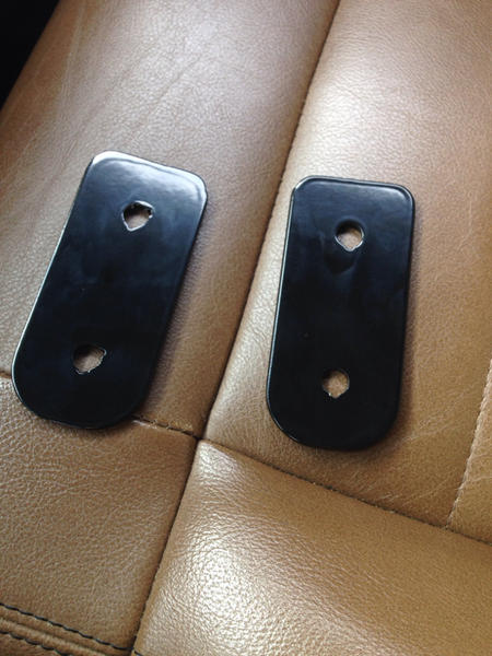

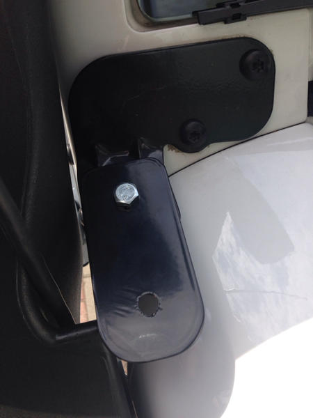

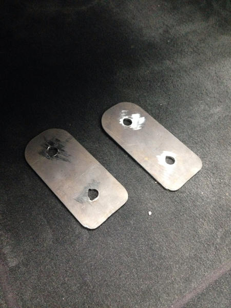

Please also be informed that standard Smittybilt light bracket from snorkel side is also should be modified or changed. I did the following.
1. Short extension bars were made
2. Sandblasting
3. Powder painting
4. Additional bolts were bought
2. Sandblasting
3. Powder painting
