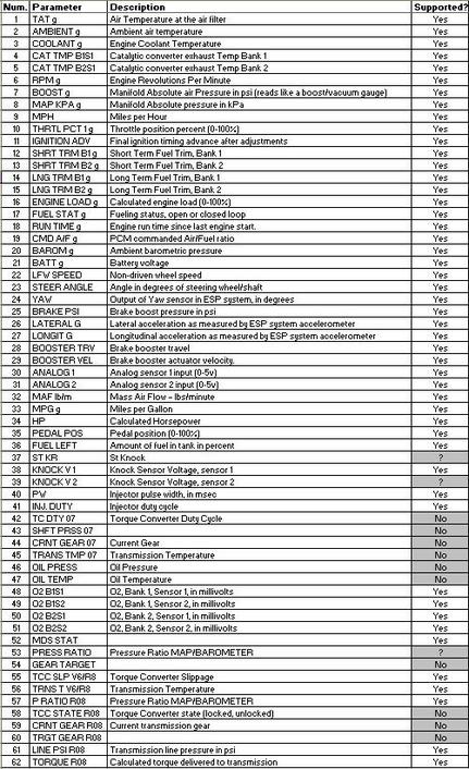

I did a little playing with the Aeroforce Interceptor parameters to figure what they are (Aeroforce's documentation is a bit short on content) and what is supported. This list isn't complete, but it is close. My unit is Firmware Version 3.3 so your results may vary. These are the Chrysler Platform 2 selections.
Edit: Updated a few.
