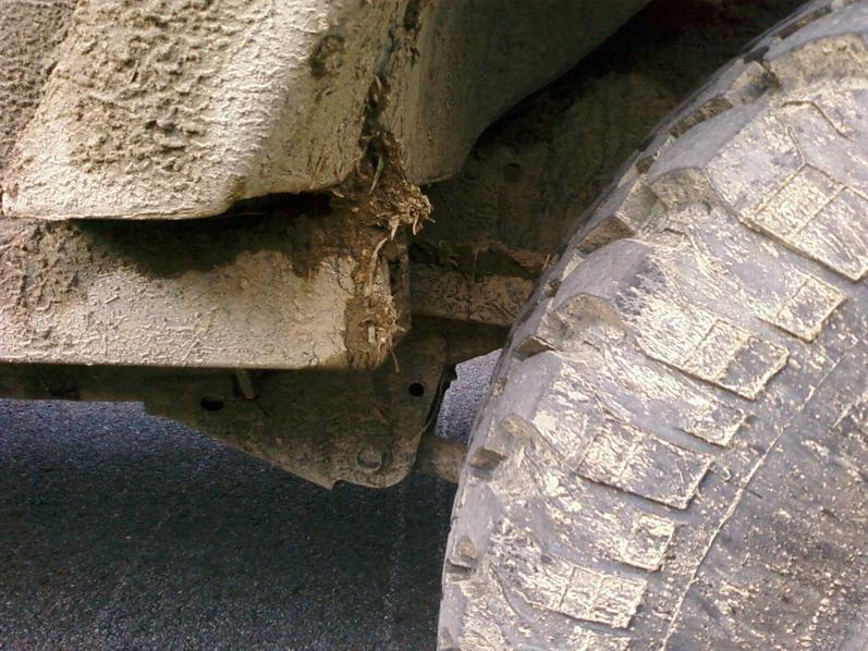

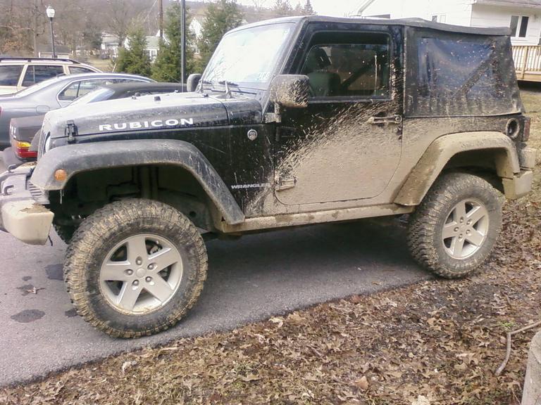

I have the 4 inch basic rough country kit that uses stock arms and no cambolts. it sounds like we do very similiar wheeling and I think you will be very happy with its performance. If the control arms and adjustable track bars of the new X-series kit fix the minor complaints I have with my kit then your set! great price for our needs! i plan on buying rough countrys adjustable x-flex arms very soon and adding 37's. My kit lifted 4" in the front and 3.75" in the rear.. havent checked since to see if its sagged at all but i havent noticed. correct me if im wrong but you dont sound like your going to be really flexing the kit to its fullest. I dont see you having any problems with 35's given the right backspacing! My only concern with 37's is my rubi rails are a little close to the back tire. Those are the stock rubi rims and tires
