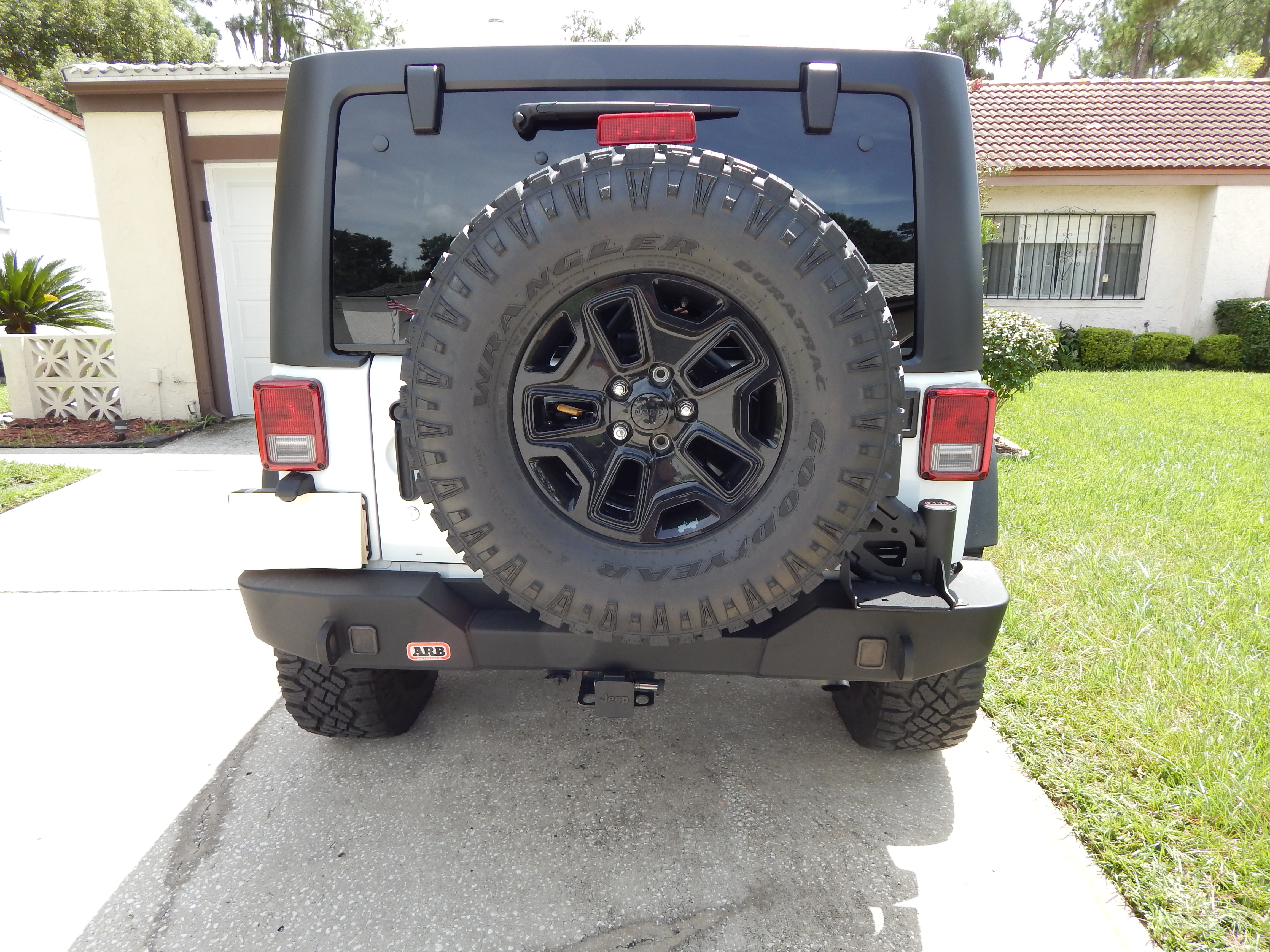

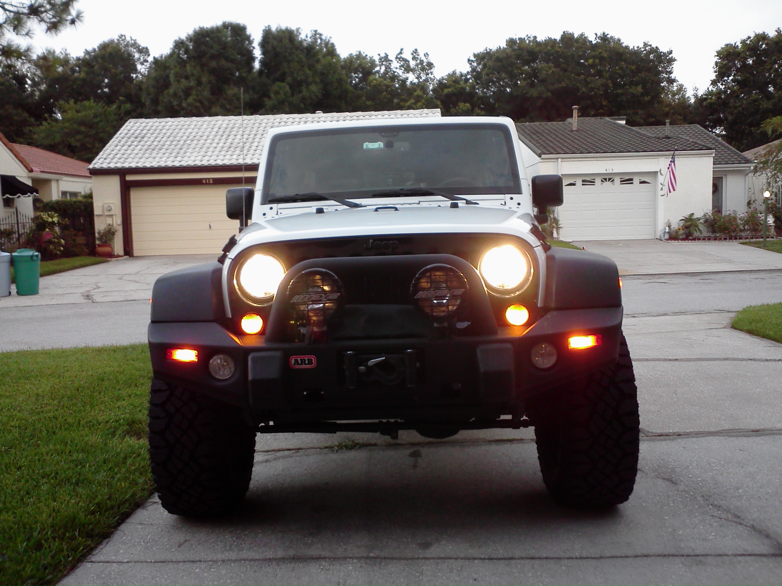

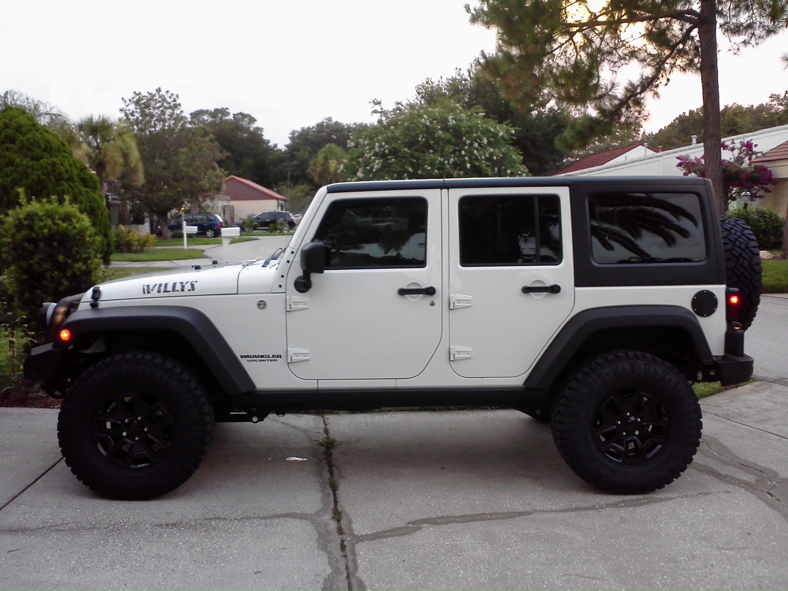

I am running AEV 2.5" DualSport XT Suspension with AEV Geometry Correction Front Control Arm Drop Brackets and Spidertrax Black 1.5” Spacers with Factory Willys Wheeler 17” Wheels and Goodyear Wrangler DuraTrac 315/70/R17 Tires. I gained 3.5" from my factory Willys/Rubicon Suspension. That is with ARB Deluxe Front Bull Bumper and Smittybilt X2O-10K Waterproof Synthetic Rope Winch which weigh over 180lbs. The rear I have ARB Rear Bumper with Tire Carrier and tire/wheel and weigh over 195lbs. AEV lifts have a rake about 1/2" and stock factory rake was 3/4". My suspension has not sag and almost level.
