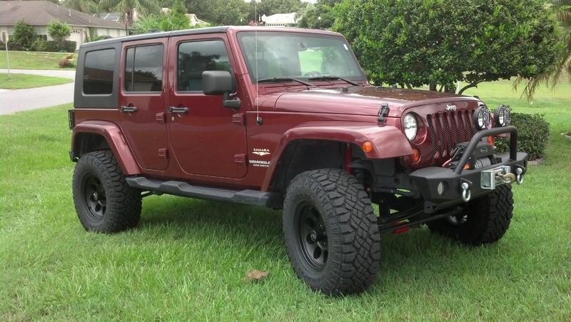

I see you have a 2013 JKU with auto.
The rear stock shaft has CV joints on both ends. They should not be a problem with an Unlimited.
The front may be an issue down the road. Make sure the drive shaft rubber boot is not hitting anything. On a 2013 a replacement exhaust crossover is sometimes needed. Also watch for grease splatter caused by the CV rubber seal at the front of the transfer case. As long as the angles are handled by the CV joints and not the front U-joint you should be OK. A little angle (less than 3 degrees) is OK on the front U-joint because you don't put a load on it at highway speed. Even then, it may vibrate some above 50mph.
I have a 4" Rancho Sport Lift on my 2010 Unlimited Sahara with auto and have not had any problems after 7 months.
