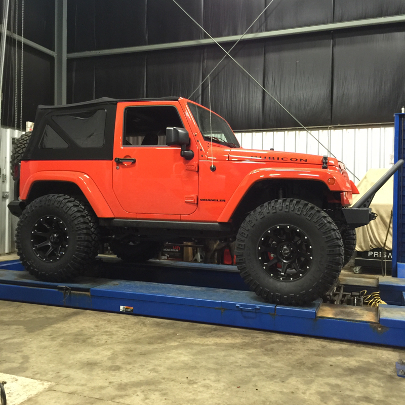

I just installed the 3.5 and 37s a couple days ago. I'm waiting on driveshafts. My previous rig had 37s and 4.10s with a manual. It drove ok, 6th gear was lame but was manageable. I'm not sure how much lift I got in total but am sure happy I chose the 3.5 X factor. Just need to install my fenders and I'll be good to go. Good luck!

I had 35s with 3.73 gears on a 6 speed and I hated it. Just on the highway though. When I had 37s I went with 4.88 gears and that was perfect. Basically, it will suck until you regear. It will also kill you MPG. Excessive gear changes and inefficient RPMs. My MPGs went up when I went to 37s and had the correct gearing.
As for lift, may as well save up for driveshafts. They won't last long with that much lift.
I'm not going to explain this topic again (search my posts as I have done it at least 5 times), but lift height has nothing to do with tire clearance. Especially for the RK 2.5 vs 3.5. If you get the taller lift, it offers no benefit while causing premature driveline wear and poor handling. Oh, and a higher center of gravity.
