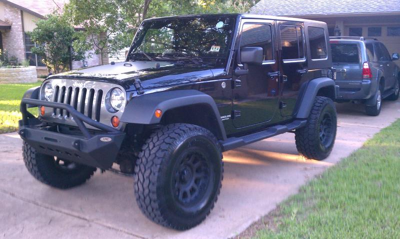

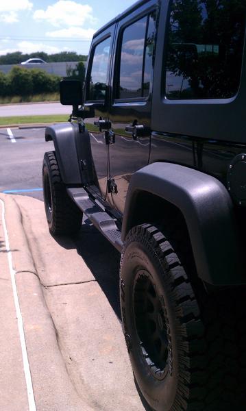

If your wheels have enough backspacing, you won't need wheel spacers. Although they would be a good idea to give that extra width since your tires are 13.50" wide and most pees only run 12.50".
You should trim your pinch seam as well.
Otherwise you should be set.
Flat fenders would be good idea for looks and stuff more.
