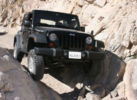

Installed the Pro Comp 4"/2" last week, took it out wheeling and love it!! Now looking at 35x70x17's My question is do I need to buy spacers to use the stock wheels and if so any commendations?
Thanks

Definitely need spacers.. SpiderTrax is the way to go..
http://www.northridge4x4.com/proddet...SPIDER-WHS-010

Double check your size, there is no such thing as a 35x70x17. It's either a 35x12.50x17 (standard size) or 315x70x17 (metric), something like that.
Saw that after I posted, thank you I keep screwing that up because I'm looking at the PRoComp vs. BFG's
