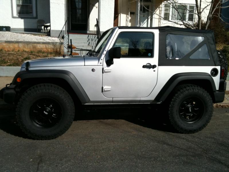

Duratracs 315/70/17
Blackrocks 909 17x8 with 4.5" backspacing
I would go with a slightly wider rim these tires feel squiggly with these rims, not scary but a very subtle movement. You will have to remove or trim the air dam. I've only driven it on the road like this.
