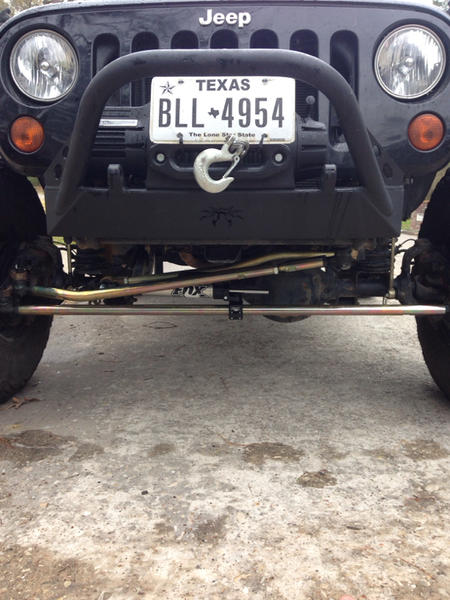

I have ran 35x12.5 with 15 inch cragar soft 8's for over a year now with an inch and a half spacer haven't had a single problem with them. I also just replaced my stock tie rod and drag link with metalcloak parts with no clearance issues.
