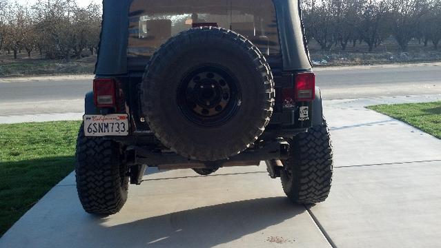

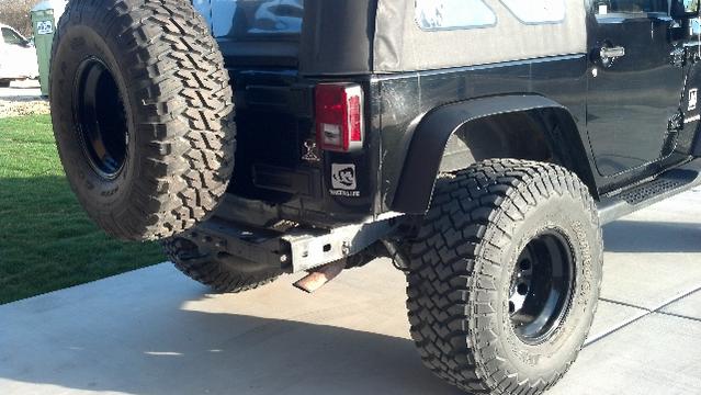

35 on stock spare tire carrier
I do as a short term solution. It's not recommend but if you do do it garb some extended bump stops, or make your own as I did and make sure everything is snug. If you go off roading make sure you throw the spare in the back of the jeep.
Join Date: Mar 2012
Location: Kingston, NH
Posts: 165
Received 0 Likes
on
0 Posts
I have 35" on my stock carrier with just a bracket that moved it up off the bumper. Works great. I hve been wheeling with no issues. Been that way for a year now.
Join Date: Sep 2010
Location: N.W. Oklahoma City, OK
Posts: 1,657
Received 0 Likes
on
0 Posts
I had the adapter that moved it up but with the aev pintlers it stuck out to far and moved quite a bit. I threw it in the back when wheeling. It started rattling pretty bad so a buddy and I took a look at it. Come to find out it was just a wiring clip rattling in the tailgate. We took the adapter off and the wheel fits nice and tight on the gate and it rests right on the factory bumper and has been solid on the trails.
Tons of people have 35's on stock tailgate with no issues. I bet more people have no issues than those that do. And I'm sure a lot depends on what wheel/tire combo you go with. A km2 on a 15 or 16" wheel will be a lot less than a Toyo m/t on the same wheels.
I ran mine on stock for over 2 years with no issue before I decided I wanted a steel bumper. More about safety than the tire carrier.
Join Date: Jul 2011
Location: Goodyear, Arizona
Posts: 1,567
Received 0 Likes
on
0 Posts
I did for a while until I started getting into really bumpy trails. Then, one day I was hearing noises and saw that the tire was pulling the welds apart. I now have a carrier.
