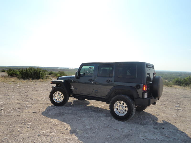

You can get full articulation with 33's on a 2.5 or 3" lift. If you run 35's I would recommend trimming fenders or running flat fenders for full articulation. Also, you're gonna want to probably run a stubby bumper or trim your factory bumper to a stubby and trim the pinch seem for the rear tires. Here's my unlimited with 33's on a 3" BDS lift. I plan on going to 35's once I change out my fenders.

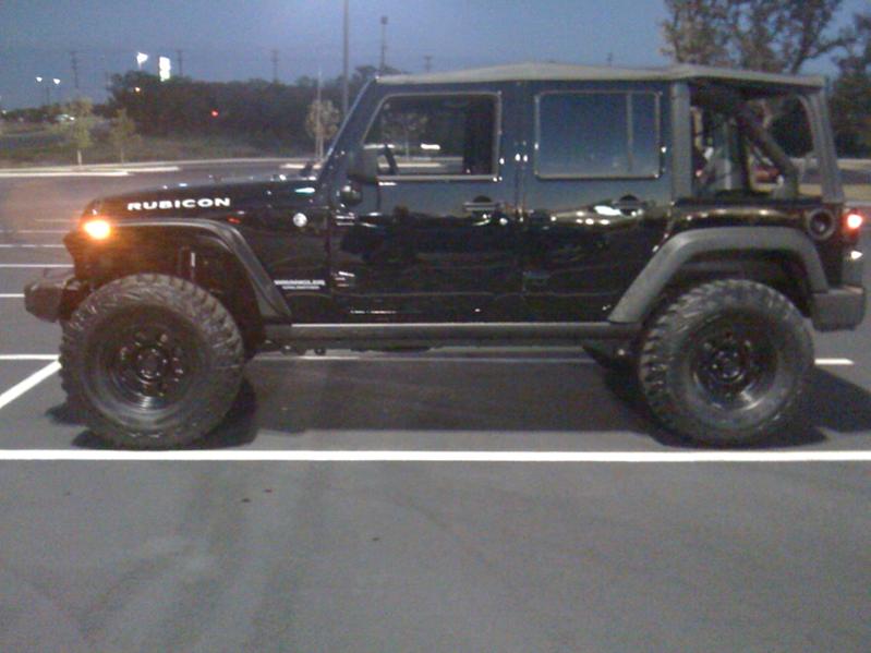

Join Date: Jan 2011
Location: San Antonio, TX
Posts: 143
Received 0 Likes
on
0 Posts
