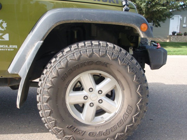

Mine
Funny I hear that discount tire wouldn't mount these. That's who did mine drove all the way from northern BC Canada to Silverdale Washington (not a coincidence that Northride4x4 is there) and back so I would have been really upset if they wouldn't mount them. I did call ahead and ask though because I was afraid of this. So far no issues but some of the wheels took a huge pile of weights to balance. I also run around 28 psi street.
