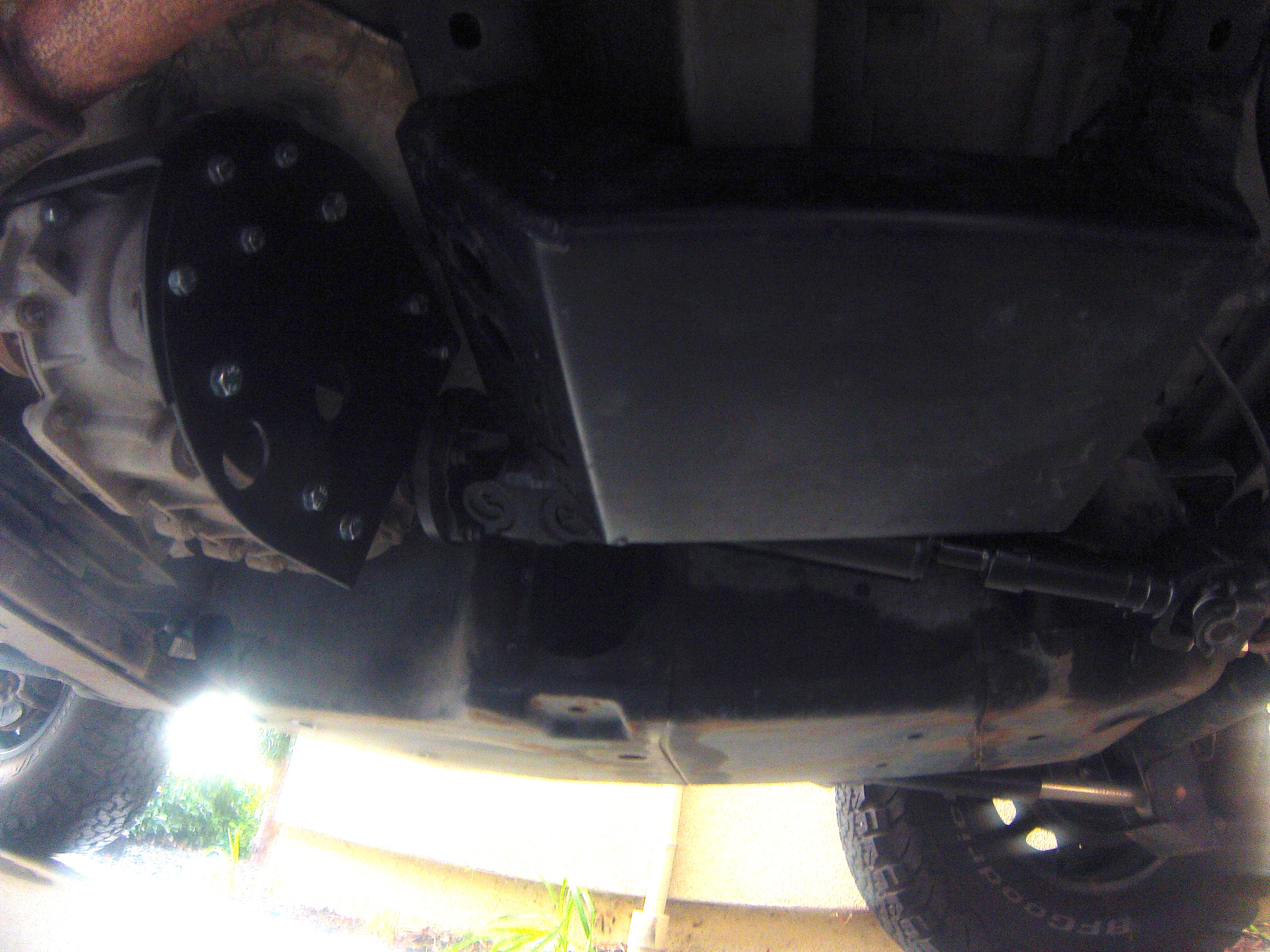

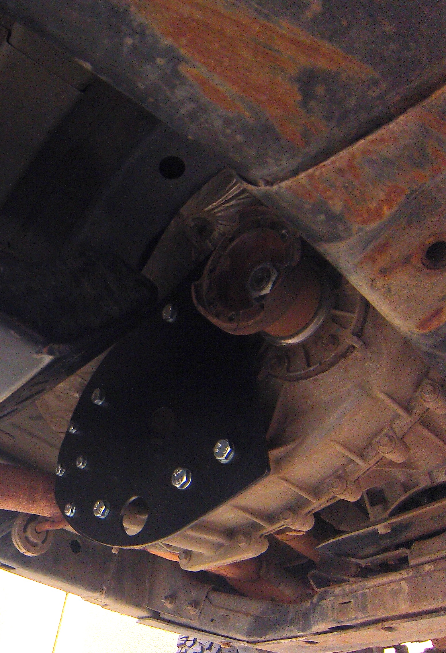

@ 2.5"-3" lift you'll be fine for now if you're still running a stock front driveshaft. When that stock front driveshaft finally gives or the stock rzeppa joint fails, you can do 1 of the following:
1. Replace the failed stock rzeppa joint with the Teraflex Rzeppa kit...
2. Or go aftermarket Teraflex dual Rzeppa driveshaft (or maybe a Tatton with Rzeppa)...
3. Or go aftermarket 1310 (or 1350) double cardan....
If you go route 3 (or plan to go this route in the future), I would take on a cheap insurance policy for the transfer case. That policy being the RSE brace since pretty much all of the transfer case implosions I know of are front aftermarket double cardan driveshaft related:
JEEP JK TRANSFER CASE BRACE
Which is the route I took on my Sahara....
my 2 cents....
