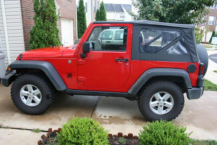

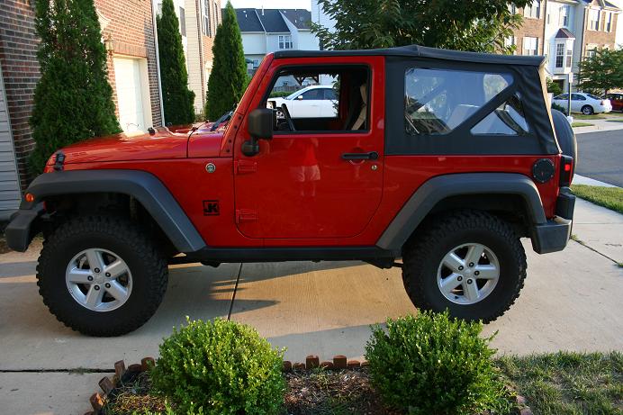

I have the same setup you're describing...stock wheels with 285/75/16 and bone stock it rubs at full extension. Once I put the 2.5" coil lift and new shocks, no more rub.
It's not an issue if you don't plan on anything where you either do some heavy off roading or you are in town and need some tight turning radius...I will say, though, that since the lift, it's really nice not to have to worry about whether I'm about to hit the limit on my turn!
Pics are before the lift and after. Tires are Firestone Destination MTs
