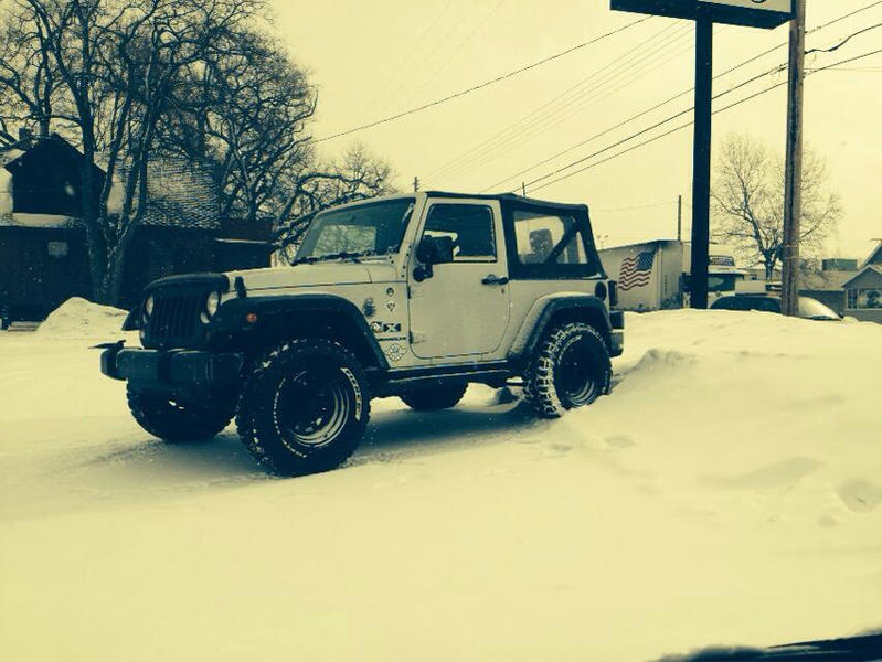

I just ordered 16" pro comp alloy wheels with 285/75/16 tires last week. From what I have read the larger sidewall will result in a softer ride (assuming similar load rating). Also saved about $250 on the set of 5 over the same wheels and tires in 17. Pro comp seems to have a good selection of 16" alloys.

I run pro comp series 51 steelers and 285/70-17 fierce mt tires a load range d got all five wheels from quadratec for 495 and the tires at discount for 212 a tire doesn't ride to bad and looks great
