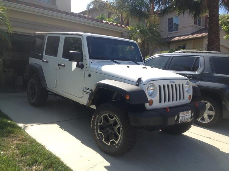

I have the KM2's on a set of 10A factory rims in LT265/70R17E with a 2.5" lift on a Sport, this is how it looks,
It rides like it should, reminiscent of a dump truck. These would be horrible snow/ice tires are they completely lack siping. There were no rubbing issues before the lift, and none after.
Attachment 499239
Attachment 499239
At least the sizing is the same...so you had em on before the lift? No spacers, right?
