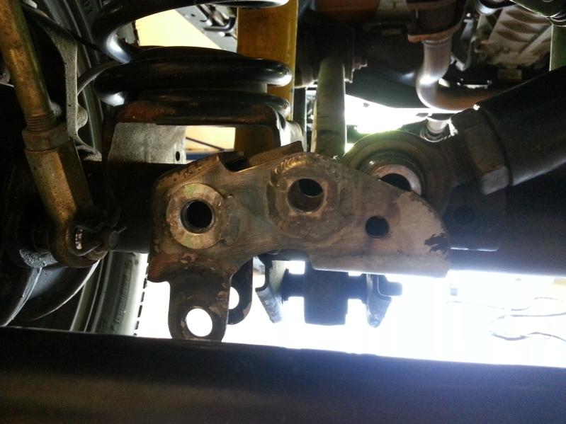

What you see here are two Grade 8 washers welded to the stock track bar mount on the axle. The fully-welded washer on the right is matched with another on the other side of the mount. The partially welded washer on the left simply acts as a spacer for the Superlift steering stabilizer relocation bracket that mounts to this location.

Forum Tech Advisor
Your shop is incompetent.
It makes no sense to install cam bolts with adjustable arms.
They did not properly torque the track bar bolts during the install--which led to the problems in the first place.
The DW from the loose track bar bolts likely was the cause of the damage of the knuckle side drag link end--which needs to be replaced if it is loose enough that it clunks during a dry steering test and/or moves up and down when tested with channel lock pliers.
Remove the cam bolts (requires welding washers or plates over the holes they knocked out) and adjust the arms to somewhere between 4 and 4.5 degrees caster.
Replace the worn drag link end.
Thoroughly inspect everything else in my written checklist.
Retorque your suspension bolts at every oil change interval.
It is fixable. Just don't drive it until you at least replace the drag link end.
