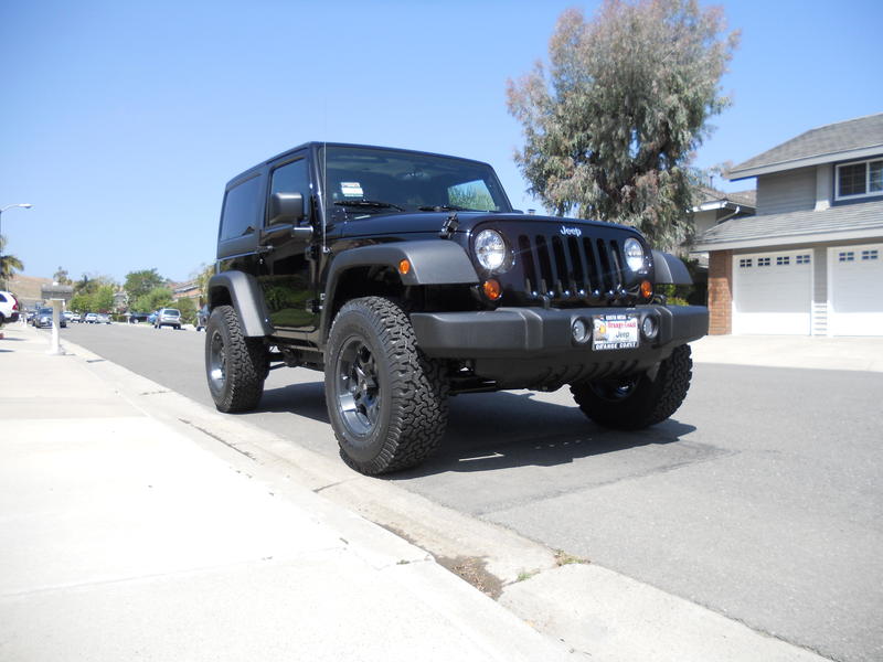

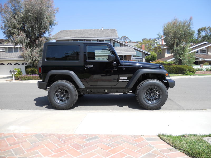

One thing to keep in mind is if you like the look of the factory rake. The rake is referring to how the front end of the jeep is a little lower than the back end. Some people like this and others put leveling kits on to raise the front. I personally like the rake and installed a 1.75" daystar bb. Here are some pics
