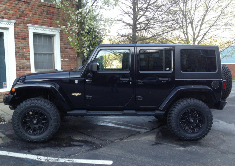

It's tough to predetermine these things sometimes. Wheel widths, tire heights, tire tread (aggressive vs. street) can all play a factor in how it looks. I had a TF 1.5" leveling kit on stock wheels/tires and it fit perfectly. Once I put on 33's it had the "stuffed" look. I ended upgrading to a TF 2.5" BB with shock adapters. 1st pic is with the 1.5", the second pic is with the 2.5". I also installed the TF HD Hinge just for a sanity check to carry the weight on the tailgate. It's easier to prevent damage sometimes than fixing damaged parts.
