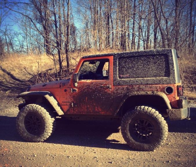

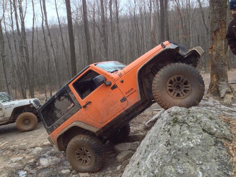

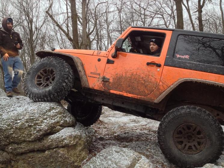

Originally Posted by JKSlow
Will the 2.5 BB with 35s looked stuffed because I have the crappy Sport OEM springs?
Not at all. Teraflex 2.5" BB and 35x12.5x15
Km2s. Didn't rub with full fenders either, but I just don't like full fenders
