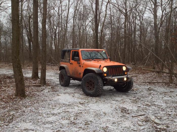

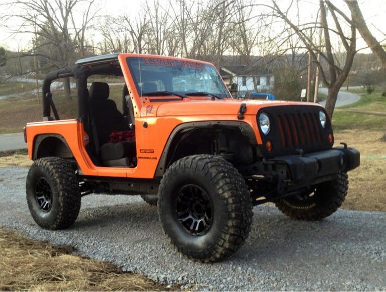

You won't have any issues with control with the 16's. I'm running 35x12.5x15 on 15x8 wheels and love it. Tires look beefier. I think you'll like it. Just be sure to run somewhere between 26 and 32 psi on the road. I run about 28-30 with mine. Also, mine gets DD'd about 60 miles a day I highly doubt you will be able to tell the difference on the road between 16 vs 17 or 17 vs 18 on a jeep. Especially with mud terrains with big lugs that flex in corners lots of people say 17's for variety of tire sizes, but if you're set on 35's and don't want some between size, 15 or 16 is fine
