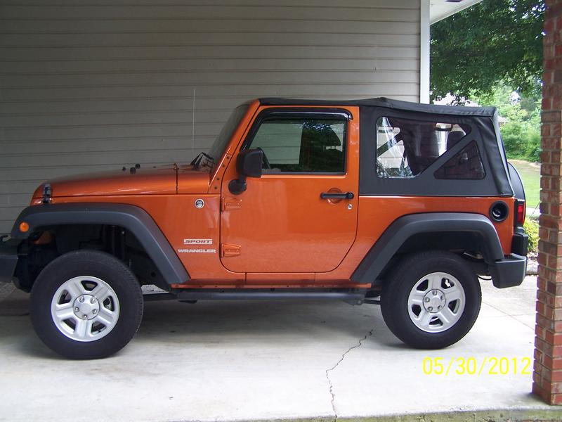

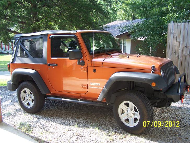

I have a stock '12 JK Sport with 14/55 springs. Currently the front rake is just over 1" lower than the rear. I have a set of Rubicon 16-17/60 springs. Do you think these Rubi springs would level it out or would it still have a slight rake to it? Thanks.

Prolly want 18s togo w 60. 19 if u get bumper or winch. Just do fronts 16 17 first ....then check your rake

Going from a 14 to 16/17 on front should get you about 1/2 - 3/4 inch. I would wait on the rears until after the fronts are installed because going from 55 to 60 (max spring rate) will probably be about 1 1/4.I had 17/59 on JKU with 3" level up front & 2" on rear and it sat level.Once I installed winch on front it sagged 1/4". I installed 18's on front and it picked it back up level. Hope this helps.
