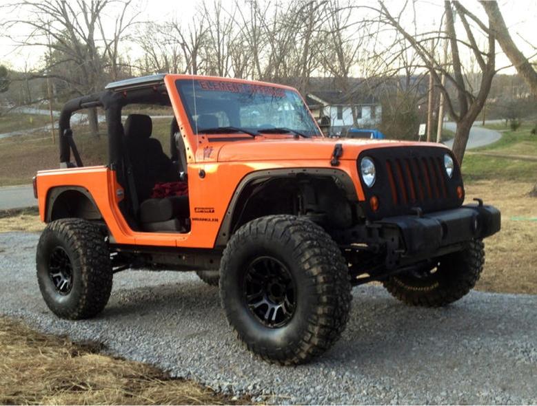

I've got 15x10's without issues and the options are really not as limited since the wheels sit out fairly far. As far as the bead goes......I've come down to 16psi (which isn't crazy low, but it is aired down) without losing a bead with 10.5" wide tires.
You'll find many people who will discourage the setup but for what I want and need- it works great and there's no need to shy away from it.

My point exactly, we're on the same page- "airing down" is different for everyone, so 10 wides wouldn't be as grand for 10-13psi. I know I won't have to go that low so I opted for wider wheels. The 8 or 9 would be great for that pressure and the typical 12.5" tire.
