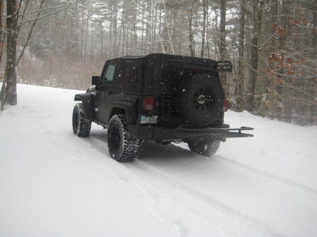

Default just get 33s
call it a day ! I love my set up with out a lift w 33s. unless your hardcore off roader you dont really need a lift. your Diff cover will still hit with 35s
& yeh were still getting snow in NH going into may grrrrr
