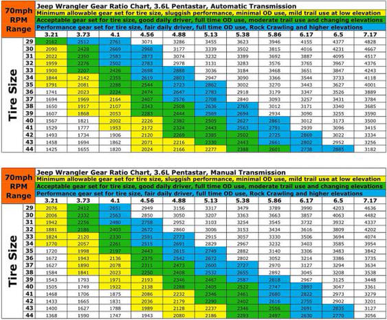

Can a fella run 35's w/o re-gearing w/ current 3.73 ratio and automatic tranny.
All the info on the FAQ says need at least 4.10 to 5.88 for 35's & 37'z.
I'm assuming that was before the extra 80HP in the newer motors.....
Thoughts, opinions, experience appreciated...

This is what I'll be running soon. For 35s it should be fine (read that as "livable") with the 3.6 motor (approx 2000 rpm @ 70mph), 37s would need a regear.
