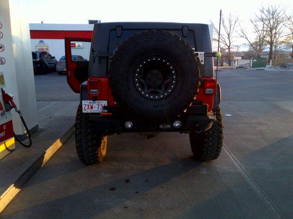

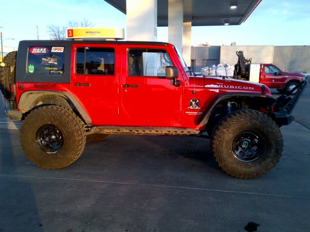

I am making slow but steady progress cutting in the rear continues, I’ve got the height adjusted as high as I would want to go should be on the road tomorrow. I'll put up a couple pictures when its done. All the best.
